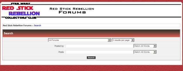

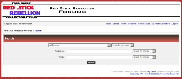

SSDExecutor
16 years ago
mddubs,
It looked to me like there was a connection in lines 402 - 412 of ForumPage.cs (see below):
private void ForumPage_PreRender( object sender, EventArgs e )
			// sets up the head elements in addition to the Css and image elements
			SetupHeaderElements();
			// setup the forum control header properties
			ForumHeader.SimpleRender = !_showToolBar;
			ForumFooter.SimpleRender = !_showToolBar;
			// register the script code to show the notification modal if needed...
			RegisterLoadString();
And this is what happens to me when I change that one setting in the web.config file:
ShowToolBar = true
UserPostedImage
ShowToolBar = false
UserPostedImage
